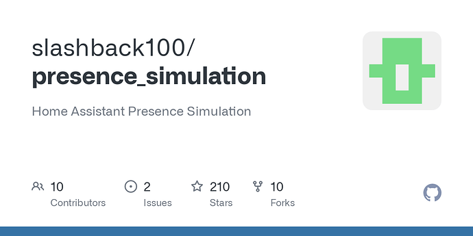

I’ve used this to good effect:
You know the drill – you’re going away on holiday and you want to make your house look as lived-in as possible while you’re away, and being the good Home Automationist (Automationist, is that…
