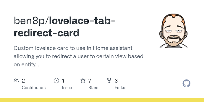

Hi, I had about the same challenge and found a good solution
This gives you the opportunity to redirect the tab (for specific users) based on the (changing) state of an entity. Works good for me.
I even found a way to make the tabs to change automatically every minute or 30 sec. …
I just set up two helper timers and an automation which starts timer 2 each time timer 1 finishes (to get the automation running I have to start it automatically once with the default action ‚timer_start‘ for timer 1 )
I added the tab-redirect-card to the first tab, making it to flip to tab 2 once timer 1 changes to idle and added the tab-Redirect-card to the second tab, making it flip to tab 1 once timer 2 changes to idle.
Very convenient, would love to see something like this embedded into core
