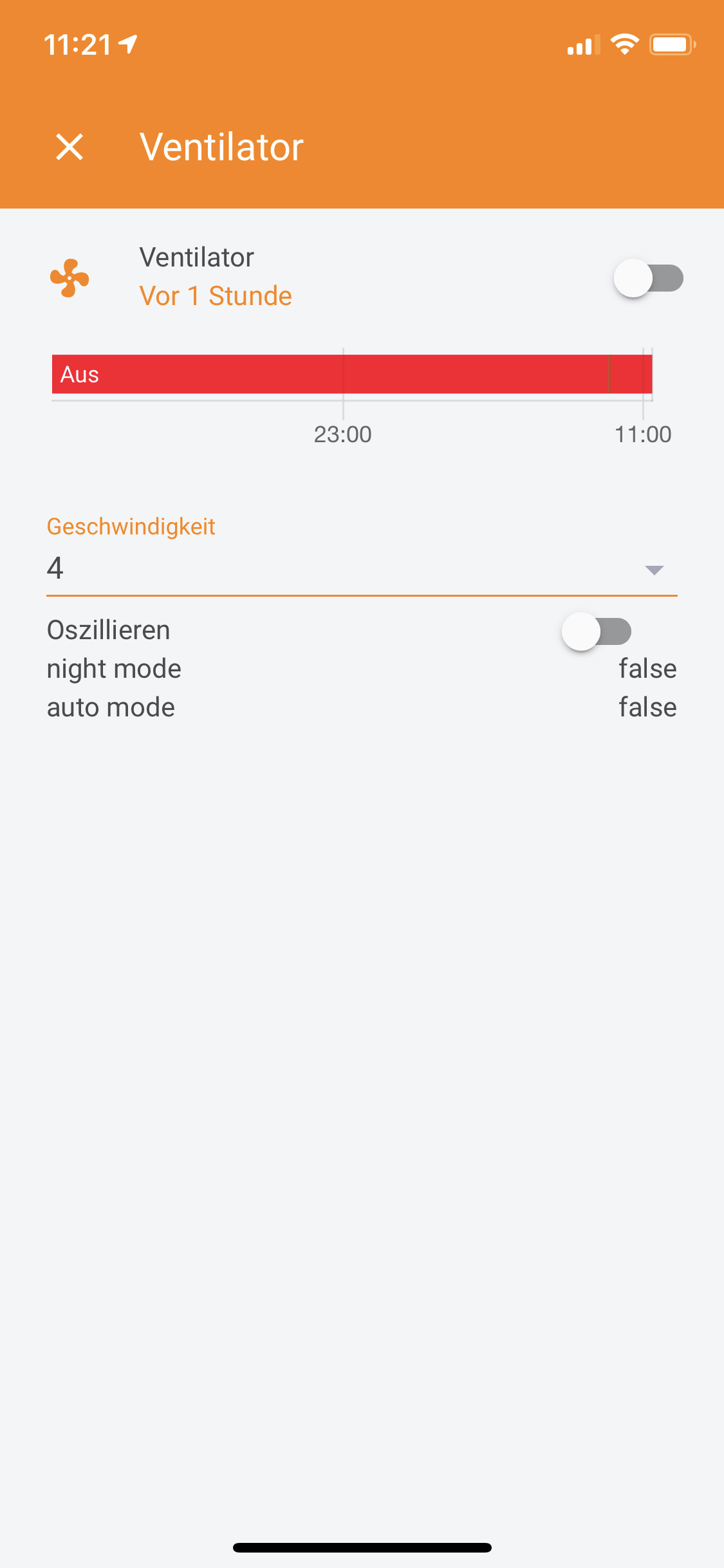

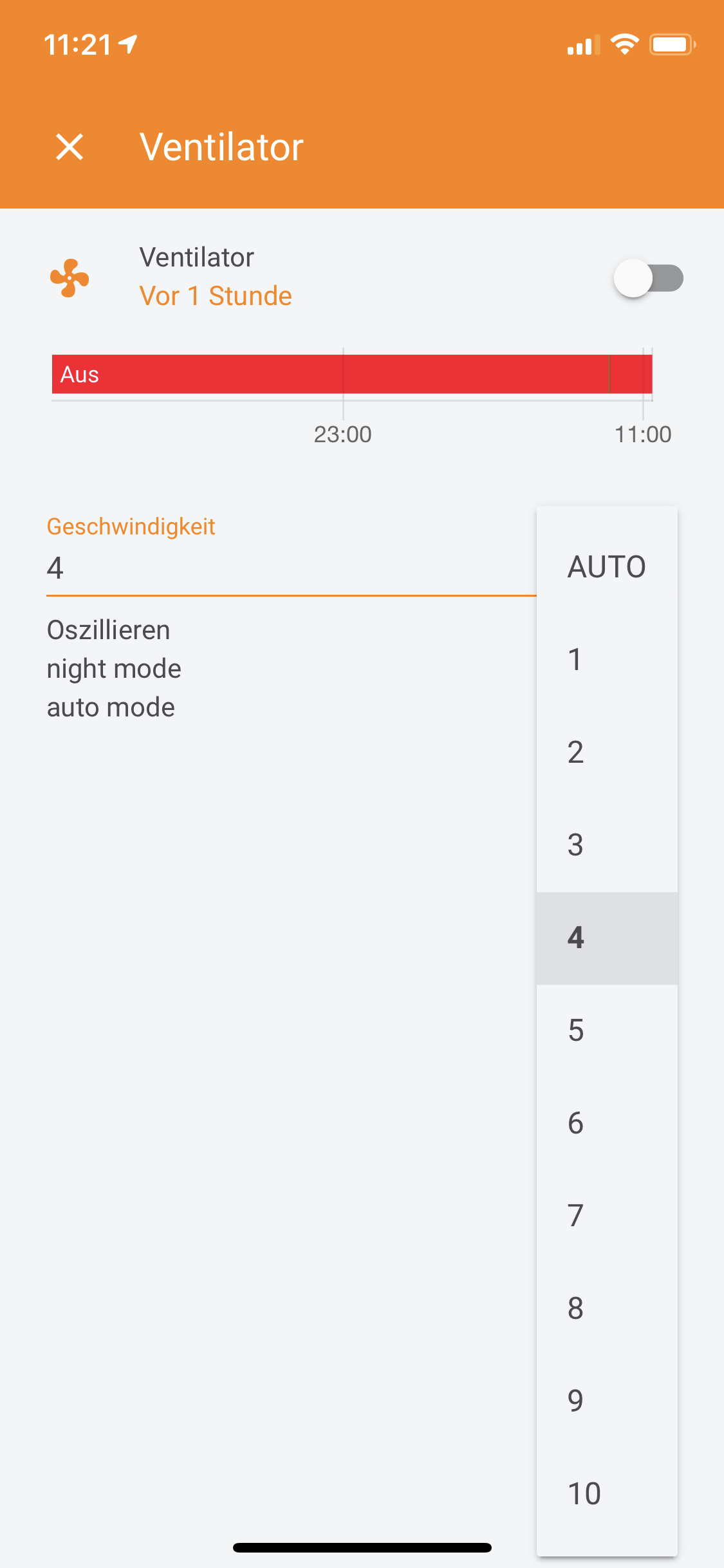

For me the Oscillation switch is in the entity. Also the speed selection. I donā€˜t need to create separate switches.
It looks like the Dyson fan integration isn’t reporting the correct state when it is in ā€˜auto’ mode. How do I report that for the team to look at?
@Krocko So what is the code for you from those screenshots?
It is the Dyson integration.
But for that are you just using this to display it in lovelace?
            - entity: fan.bedroom
Donā€˜t understand, sorry.
I have added the fan to an entity card.
This is the 'more infoā€˜ view. You get this, if you tap on the entity name (not the toggle) in this card.
The screenshot you posted. Is that after you click something? If so, what code in Lovelace have you used to get that card
