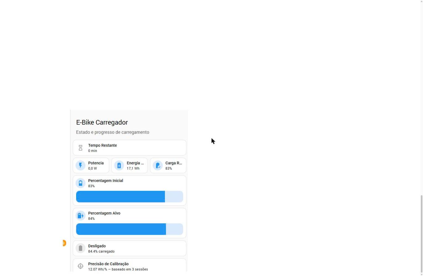

If you charge an e-bike (or any battery-powered device) through a Shelly plug with power monitoring, here’s a setup that goes beyond a simple on/off relay: it estimates the battery’s State of Charge from energy consumption, shows a live time-remaining estimate, automatically cuts power once the target % (or 100%) is reached, and self-calibrates its own accuracy over time.
Hardware
Any Shelly plug with power monitoring (Plug S, Plus Plug S, Pro, etc.) wired to the charger. That’s it, no extra sensors needed, everything else is template sensors and automations inside Home Assistant.
How it works
A template sensor estimates SOC using the % you set as the starting point, plus the energy consumed since charging began, divided by a calibration factor (Wh needed per 1% of battery). Four automations manage the session lifecycle: detecting charge start (power rises above a threshold for a few seconds), detecting the target % being reached (switches the plug off immediately), detecting real charge end/idle (power drops and stays low for a few minutes, in case the battery’s own BMS stops charging before your target), and, the interesting part, auto-calibration.
Every time you confirm or correct the “real final %” (because you actually checked the bike’s own display), the automation compares your correction against its own estimate and nudges the Wh-per-percent calibration factor with a weighted average (70% old value / 30% newly observed value), clamped to a sane range. A small counter tracks how many calibration passes have run, so you can see the estimate’s accuracy improve the more you use it.
The dashboard card (Mushroom cards) shows time remaining, live power/energy, starting/target/real % sliders, and a status tile whose icon changes color: grey battery when off, red while actively charging, green once the target or 100% is reached.
Dashboard
Blueprint
