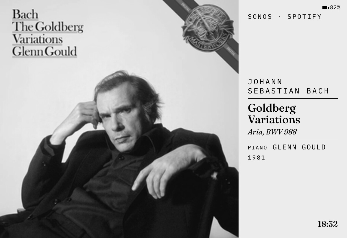

  • Now-Playing — whenever Sonos starts, the panel switches to album
    art + track info. Classical recordings get a composer-anchored layout
    (work / movement / named performers); pop falls back to artist /
    title / album.

Sample (i’m allowed to add only one image in the post)
(Screenshots of all five faces are in the README.)
