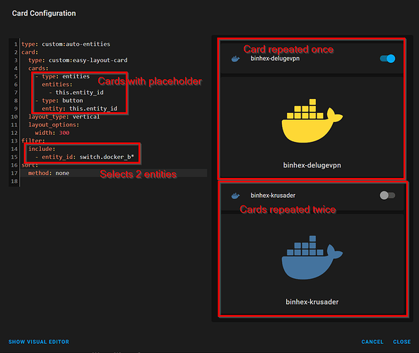

I have recently tried to set up a dynamic docker dashboard:
I have struggled quite a lot to get it automatically populate and look the way I want it. The biggest struggle for me was nesting the layout cards and figuring out how to properly configure which part the card is going to duplicate, because in combination with the auto-entities card, the configuration for the created card actually needs to be added as option parameter.
For me personally it makes the most sense to just replicate the cards section for each entity and allow to use a placeholder for the entity. Of course this has the drawback of not being as flexible, as you are not able to add special behavior for each entity anymore.
Since I really like the layout-card by Thomas Loven, I have based it on his work(https://community.home-assistant.io/t/layout-card-take-control-of-where-your-cards-end-up) and thought maybe someone else can benefit from it as well.
It is currently not available in HACS, but you can deploy it as a custom repository. NOTE: You will need the original layout-card installed!
This is the github repo:
If you have any questions, please let me know, I have currently only tested it for my own usecases!

@kamtschatka Thank you for the work on this card. Should make it much easier!
Would you mind posting the yaml and other requirements to create the dashboard in the picture you posted? I am in the process of creating a statistics view and this would provide inspiration.
Gladly(see below)
