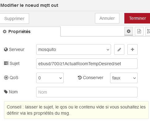

To write request on the bus you simply need an mqtt out:
{5050198A-C51C-4CCF-94F4-94213391B6D5}
Something like this:

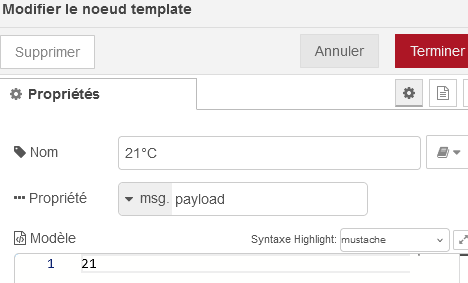

Just remove the unit in the payload:
