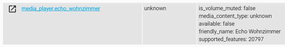

I also testet amazon prime yes. It seems that no status at all is getting collected:
How can I best debug this?
I am using newest hassio and sitting in germany.

Ok I did further debugging by myself and now I get the following:
curl -d '{"deviceSerialNumber": "G2A0P30774060QRT"}' -H "Content-Type: application/json" -X POST http://192.168.1.11:8091/alexa-getState
{"statusCode":403,"body":"{\"message\":\"user not authorized\"}","headers":{"server":"Server","date":"Fri, 06 Jul 2018 13:06:18 GMT","content-type":"application/json","content-length":"33","connection":"close","x-amzn-requestid":"5ebb2e6a-811d-11e8-ba66-955c17d0600e","x-amzn-alt-domain":"https://alexa.amazon.de/logout","vary":"Accept-Encoding,User-Agent"},"request":{"uri":{"protocol":"https:","slashes":true,"auth":null,"host":"pitangui.amazon.com","port":443,"hostname":"pitangui.amazon.com","hash":null,"search":"?deviceSerialNumber=undefined&deviceType=undefined","query":"deviceSerialNumber=undefined&deviceType=undefined","pathname":"/api/media/state","path":"/api/media/state?deviceSerialNumber=undefined&deviceType=undefined","href":"https://pitangui.amazon.com/api/media/state?deviceSerialNumber=undefined&deviceType=undefined"},"method":"GET","headers":{"Cookie":"session-id=138-3162072-7641115; session-id-time=2161602325l; csm-hit=7DFV7P9MWFBZBAPHP8W8+s-7DFV7P9MWFBZBAPHP8W8|1530882334424; ubid-main=130-7496092-0604654; x-main=ZNRyKN5Obtzcn6HO3FJqqoziaBeSEBOr; at-main=Atza|IwEBIFZ2MVwjn1lzv2J-khKw0qy1tg034BI2-HRg5u5qMxkRM1D1yCXXNAr87idwLwGeJPHVMP0894n_IZqiowMg7REzz7NGItVwrGs0rFq5KyubamjAu-i4JnMU2nc09qdkOJ7TkfqBo4W92yFjW_8GJr5axbHmXaadHcW7HHRtb1PBPEiMJMoM0R-ZIxBA2XPFUzyqMQzfGcAf2GripK6RWZPpTygscfi0GNY-UZNwrynThsClpkAVrXn-OiEsPfy4RaZA0Q4oNCdGrwhjx6-AYMKfmKCgZZUTbrktsEV4KrcqOCsqnO6LWsv1CwNSzxPv1BRZSHBLEFq7M5F1yfuWgkyUEihoA1QosjWWh1qreI7YHY5bQaBEGVNcrNufR6zX0B8pf6IwBR07yJYaW-MVUO5J; sess-at-main=\"xdZ2GTeWB3+VkscAstz8/bTkfpySjMcM5Iau/WVJz+M=\"; csrf=775519716; ","csrf":"775519716"}}}#
Now I have no further plan whats going on…
