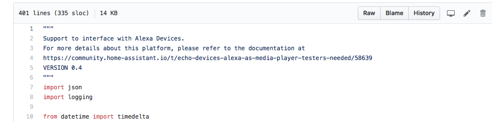

0.4 released (for both the custom_component and hassio add-on.
Please be sure to update both the add-on and place the update alexa.py file in your media_player custom_components directory.
[https://github.com/keatontaylor/custom_components/blob/master/media_player/alexa.py]
Make sure you see VERSION 0.4 when downloading.
