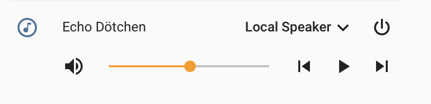

My Echo Dot:
Code:
type: 'custom:mini-media-player'
icon: 'mdi:music-circle-outline'
volume_stateless: false
toggle_power: false
group: true
info: scroll
max_volume: '100'
min_volume: '1'
volume_step: '2'
entity: media_player.echo_dotchen
source: full
sound_mode: full
artwork: full-cover

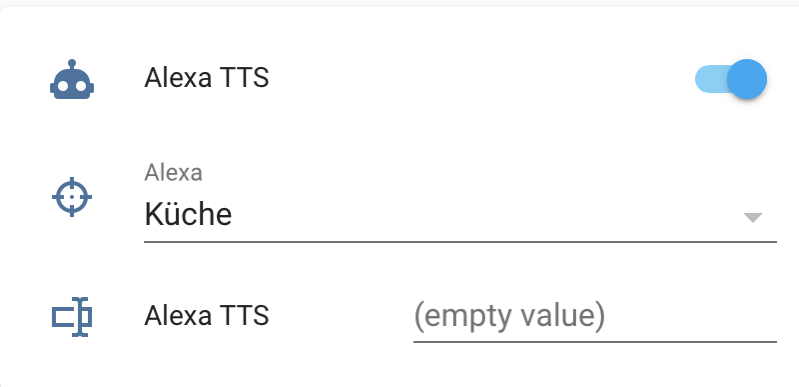

Alexa talking:
Code:
type: entities
entities:
  - entity: automation.alexa_tts
  - entity: input_select.alexa
  - entity: input_text.alexa_tts

thanks for the reply, but i do not know what wrong. But the echo is not responding when i use the slider. And when it’s in standby the card stays grey. When i use the phone app and slide the volume then it awakes in HA, but i can not control anything.
