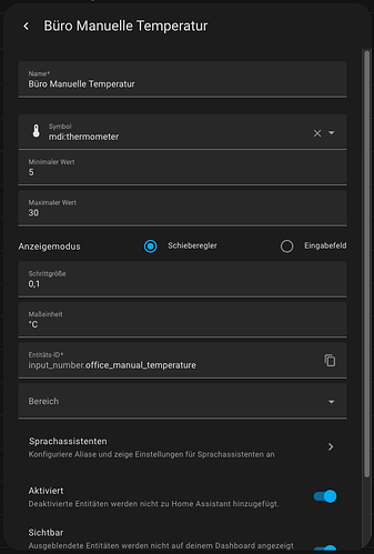

Manual Temperature
Needs to be an Input Number Helper. Mine is configured like below.
