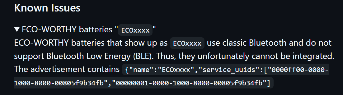

Just got an Eco-Worthy 12v 100ah, and the one at the top keeps saying it can’t connect to the MAC address (I’m using the one the Eco-Worthy Android App shows), the HACS one says it can’t do those that appear as ECOxxxx as they are regular Bluetooth not BLE.

Here’s what the HACS integration shows (the author there appears to have done a lot of different batteries):

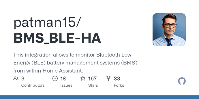

I used the
‘BLE Battery Management System (BMS)’ plugin which can be found on HACs
or GitHub - patman15/BMS_BLE-HA: This integration allows to monitor Bluetooth Low Energy (BLE) battery management systems (BMS) from within Home Assistant.
Does your battery identify as ECOxxxx? See the screen shot I posted above and that HACS’ integration comment that those are not supported. Mine does, and doesn’t seem to show up in my ESPHome Bluetooth proxy.
