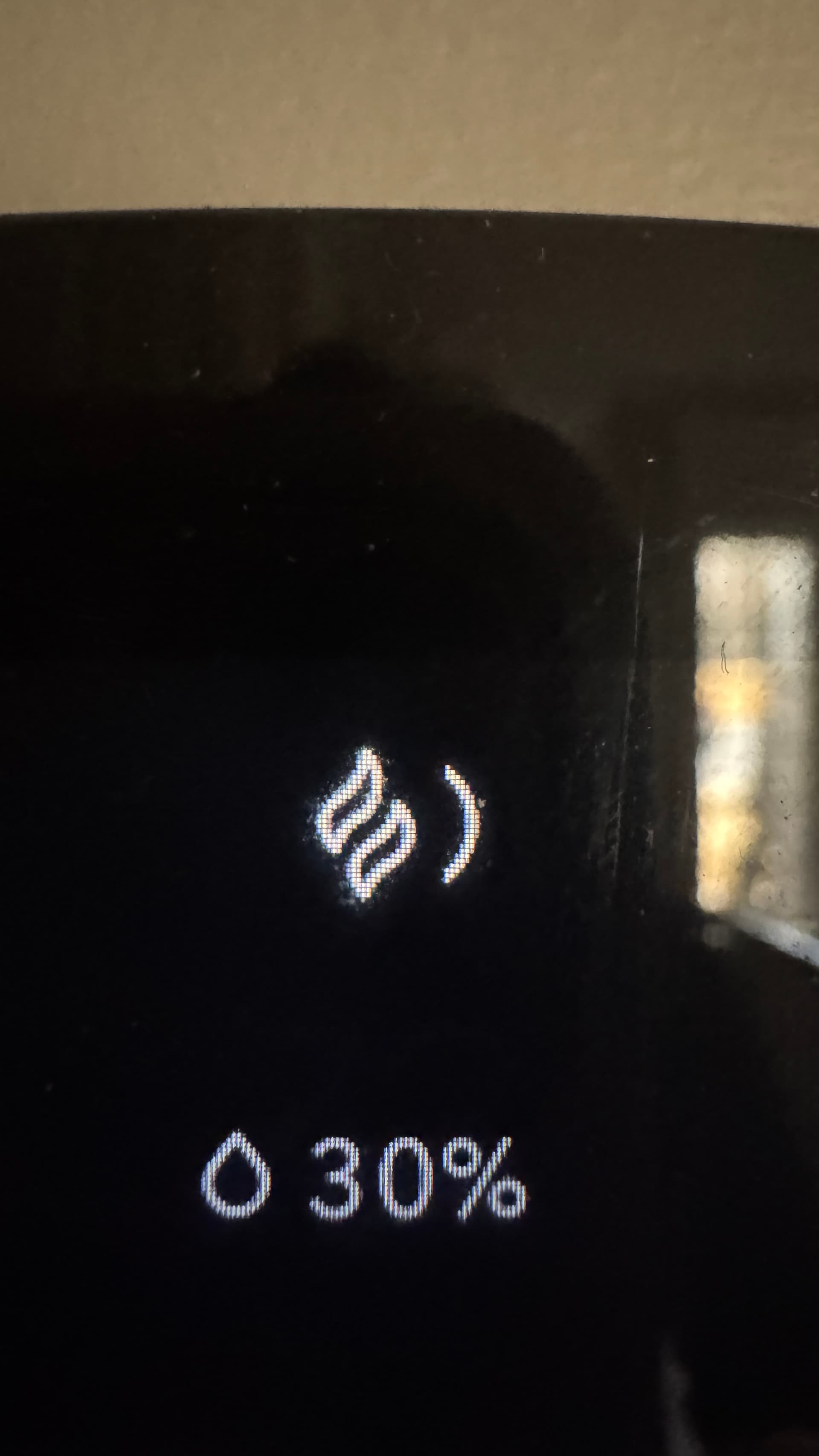

I connected my Ecobee 3 thermostats to HA today and when I use HA to switch the mode to heat the thermostat display shows a version of the heat icon that I have never seen before (picture below). Anybody else have this? Is it an auxiliary heat mode or something similar? It doesn’t happen when I switch to heat from the Ecobee app. Thanks all!
