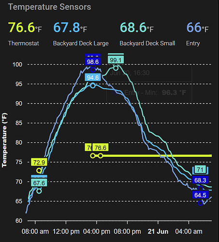

In my case it is directly correlated to the ecobee going offline. Every time this happens I lose the thermostat’s sensor updates. As soon a I reload the HK integration for the ecobee the sensors begin to update again. If the ecobee remains up the sensors continue to update indefinitely (for weeks at a time now).
EDIT: If you are looking for a 100% repro, unplug the ecobee from the wall for a couple of minutes and then plug it back in. I have drywall and paint work going on at home and have done this several times, and each time the sensors stop reporting after plugging it back in while the climate entity’s states/attributes continue to update as normal.
The states (for temp and humidity) on the climate entity continue to update for me when the exposed sensors do not. I’ve created template sensors for those states and can use them reliably. The only downside is that the temperature is in full degrees instead of tenths.
