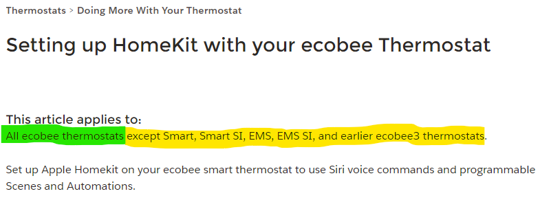

Apple’s Homekit is an automation protocol. It’s available on all recent Ecobee thermostats except specific models listed in Ecobee’s support documentation:
So, no, you don’t specifically need the Premium model to integrate it with Home Assistant via the Homekit protocol.
