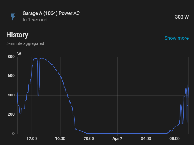

Here is 1 of the microinverters monitored in HA:

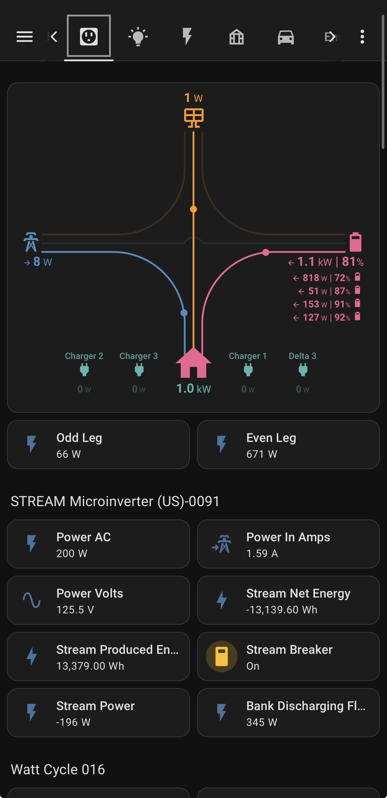

I’m working on supplementing my powerwall 3 with a diy battery bank, that I’m using a stream micro inverter cover lighter loads saving the powerwall for higher wattage loads. I have the inverter going into a dedicated 20 amp circuit. The problem I’m running into right now (may be more seasonally caused as not running HVAC right now) but the 2 legs of my panel are not staking close. So I’m going to pick up a second stream micro and ad another dedicated circuit and outlet for it on the opposite leg, both will feed from the i 48v battery bank.

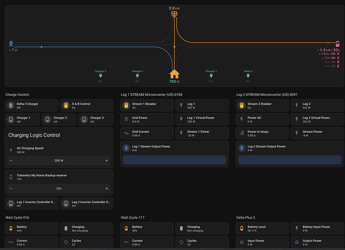

Batteries are charged with separate charges. Right now I have 2x 1 kW chargers and 1x 500 W charger that I use with a ecoflow delta 3 pro in the mix too. Everything is tied to the same 48v copper bus bars and the chargers are controlled by zigbee plugs with power monitoring. I wait until my powerwall 3 is charged or is charging with significant excess and selectively charge the battery bank with the various chargers anywhere from 200W via the minimum from the delta 3 to about 3.7 kW max when all are on.
I picked up 2 ELTEK Flatpack HE 48vx2000W power rectifiers that can be controlled with ESPHome over CAN and will be integrating those as well. I also have a Victron MPPT I will use when I get some additional panels - mainly to charge separate the main solar system.
When charging or idle I adjust the micro stream inverters to 0 output (for some reason I had that 200W was the minimum and would use the Span switches for the circuit each was on).
