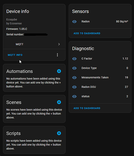

Just recently published a project, specifically just an addon to get radon readings from Ecoqube devices into Home assistant.
Project: GitHub - starsoccer/ecosense
Credit to original post that showed how to actually get data from the device, Reclaim Your Data: Freeing a Wi-Fi Sensor from the Cloud - Embedded Artistry

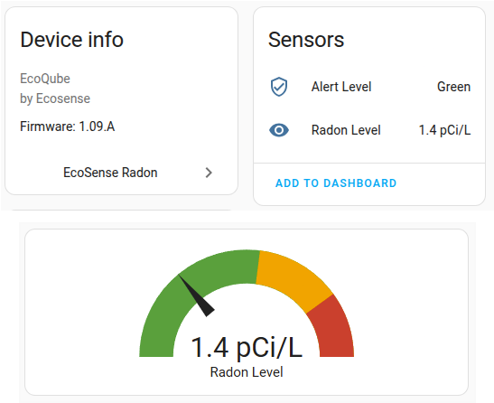

For anyone interested, I’ve created a HACS integration that pulls the data from the Ecosense cloud: GitHub - rwestergren/hass-ecosense-radon: Home Assistant cloud integration for EcoSense radon monitors
Nice, thanks for posting this, great to have another option in case they somehow update the device and brick it working locally
