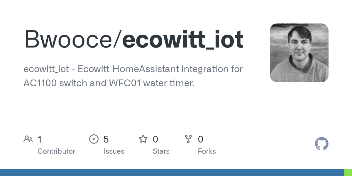

Has anybody gotten news on whether we can get the WittFlow WFC01 integrated into home assistant. Would be great if we can toggle the water flow via HA
Try this:

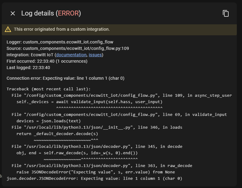

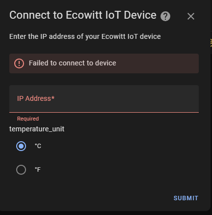

Mmm, not getting the integration installed! When I want to add the Ecowitt IoT integration and type my Ecowitt local IP I get the following error
See below the log details
Any ideas? Thanks!
