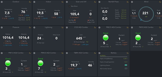

Yesterday I received the ’ brand-new’ EcoWitt WH46D. In the HA integration not all the entities are present. For example pm1.0 and pm4.0 are missing, while pm 2.5 and pm10 are present. (how) can these be added?

I turned on the WH46D and it automatically connected to my Whether station display/gateway. (HP2564AE_Pro_V2.0.1). In HA, the Ecowitt integration showed the extra/new entities. But not all of them. I looked to the Device info / sensors, like the picture I shared.
Check that!
Yes, I see all the values on the WH46 (of course) and also on the ECOwitt display, and on the Ecowitt weather website.
