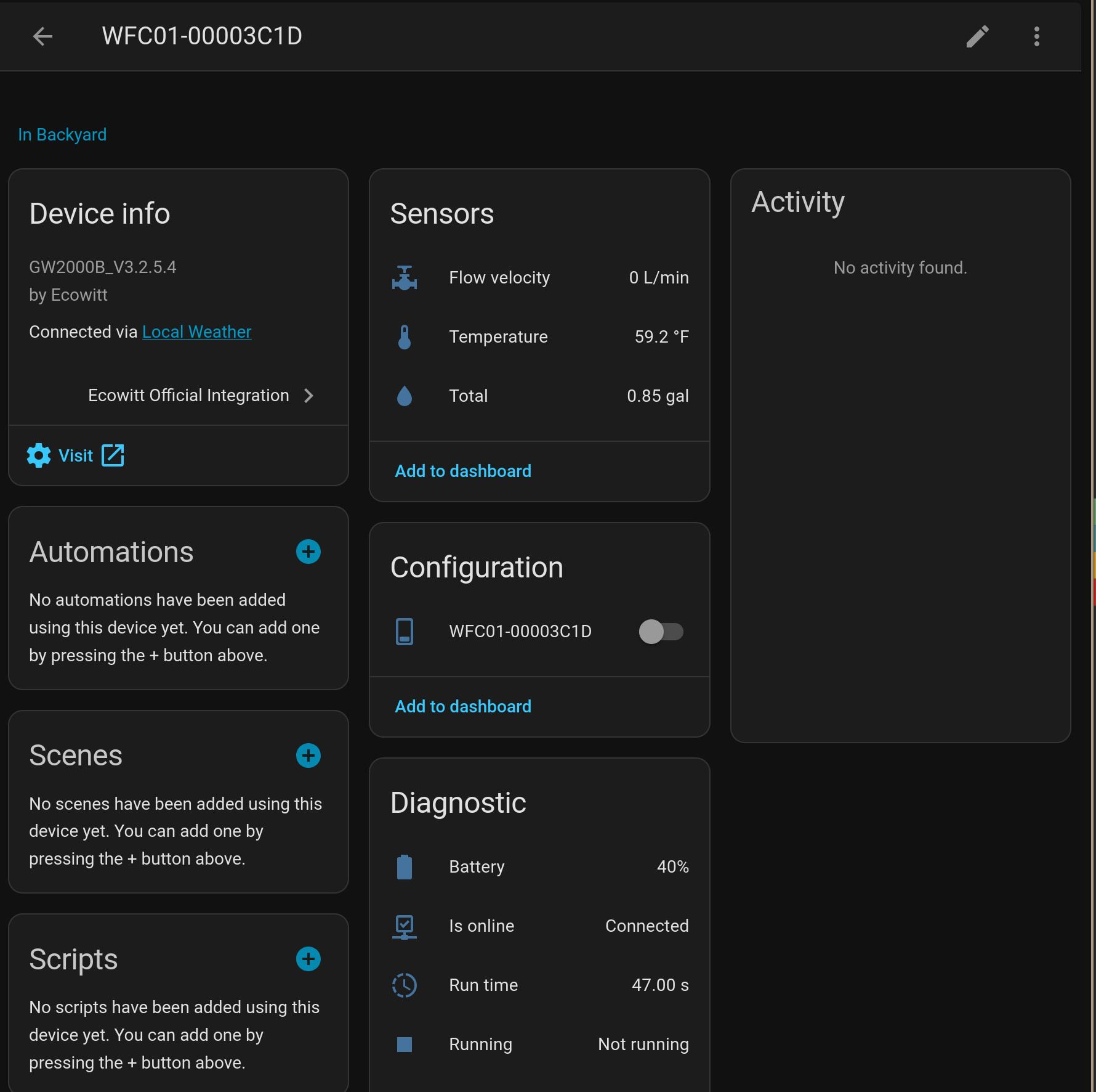

Ecowitt has a new official integration in HACS and it recognizes and allows control of WFC01. GitHub - Ecowitt/ha-ecowitt-iot: This integration uses the locally available http APIs to obtain data from the supported devices inside the local network.
Does it allow to control devices?
@mplogas As I mentioned it will control the WFC01 (toggle on/off) if that’s what you mean by control devices.
