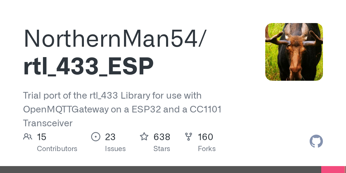

Not being too sure if your Vevor has been one of the decoders which has only been added recently to rtl_433_ESP, it might be safest to install the latest dev version when trying this out, just in case the Vevor decoder was not included in the last 1.8.0 build already.
and make sure you upload the lilygo-rtl_433-fsk binary, as your Vevor broadcasts with FSK modulation.
