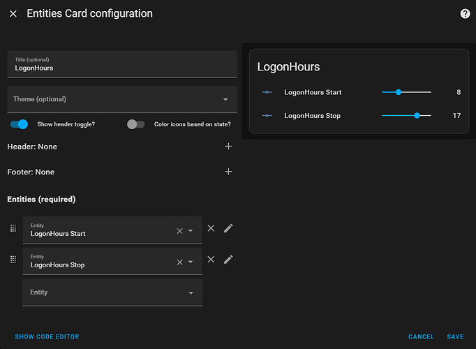

Next step is to creat an Entities card in one of your dashboard.
My card setup looks like this
And here I’m able to change the start and stop hour for the logon.
The final result looks like this
