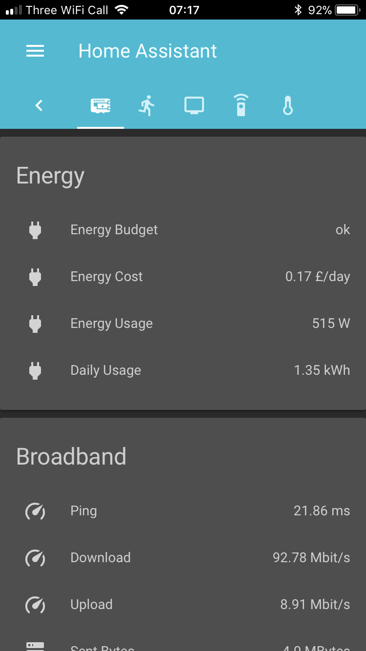

Here is my sensor yaml with the new current values added at the bottom. I also modified the name in the customize yaml
  • platform: efergy
    app_token: !secret efergy_token
    utc_offset: 0
    monitored_variables:
    • type: instant_readings
    • type: budget
    • type: cost
      period: day
      currency: ÂŁ
    • type: amount
      period: day
    • type: current_values
It’s fixed now so you should be good again. I have closed my issue on GitHub.
Thanks for your info! I tried the current_values type and that worked perfect.
