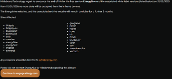

One more proof that we need to have local functionality, is the Efergy energy metering platform going down this year. https://engage.efergy.com/
I’ve been using it for almost 10 years now with no problem.

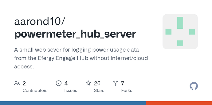

That web server idea where web traffic is interrupted and redirected to a local web server sounds like the basis of an viable integration to feed the data either directly into HomeAssistant, or more broadly into something like MQTT for more universal use. Time to break out and wrangle some Python code! That db.py code looks like a tasty portion to start with.

I spent all morning to day trying to do something similar, and intercept the hub’s efforts to connect to efergy, and I must say (although I am ignorant, with the help of chatgpt) I managed to get a running log of the increasing daily consumption.
But with a hundred problems.
So it is doable, but I just want to make sure it’s impossible before I go and spend a fortune on three shelly 3phase sensors.
