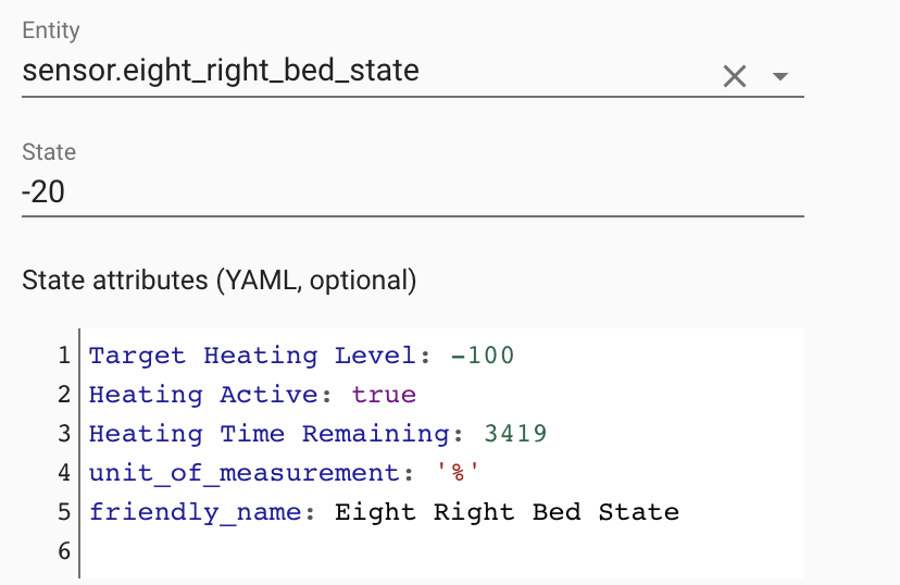

I have the pod and have it set up with home assistant.
It looks like this:
Setting the temp to 1-100 still works correctly. If I try to set it to any negative number (like -5 or -80) it sets the target temperature to 10. So its probably a quick and easy fix, just somehow allowing it to do negative numbers correctly.
I guess i can’t post links so the image didn’t work. Here is what it looks like on my end:
So the fix might be as easy as allowing negative numbers to be passed.
Interesting. Would you be willing to open a feature request issue on the pyEight github and do some API queries for me with something like Postman? If you can supply the api results for a Pod I should be able to make the necessary changes.
I can try. It’s not something I’ve done before but I’m sure I can figure it out. I will be away from home Tuesday-Saturday, so I won’t be local to the Eight Pod if that matters. I have setup Postman and installed pyeight. Running me through it would help. Would I open a pull request on Github?
I’d like you to open a github issue (just title it Pod Support) so I can track the progress within the library repository. I’ll give you details on what URL’s and header values to use and you can post the json responses. Once I have an example from a pod I can figure out the differences and make the right adjustments.
