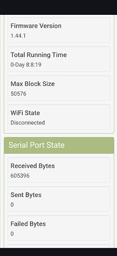

The server shows up on my LAN and I’m able to get the configuration page. I’ve even upgraded firmware to the latest v1.44.1.
You can see on the status page, the WiFi State is ‘Disconnected’. The device also does not show up in the list of connected devices on my LAN. The led lights on the device are lit up (blinking) and you can see that there has been data received, but none sent (see below).
So, WiFi seems to be working (since I can connect to it as a server) and it appears to be receiving data from my RS485 device (pool controller), but its not connected to my network router (i.e assigned an IP) and, of course, not sending data.
