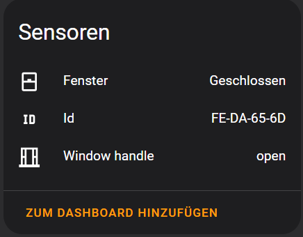

Hello Philipp,
when I put it under sensors I get a third entity called “windowhandle”. This one actually indicates the state correctly, but of course it is not the correct device class.

Hello Steffen,
the binary sensor is fixed on main now.
for the sensor can you just edit the device class manually to window in HA? Not sure if this is possible.
Hello Philipp,
thanks a lot for fixing the binary sensor. I will just wait for the next update to come out.
Regarding the device class, I already defined it to door or window, but those entities will always display closed. Only the entity window handle will show the correct state
