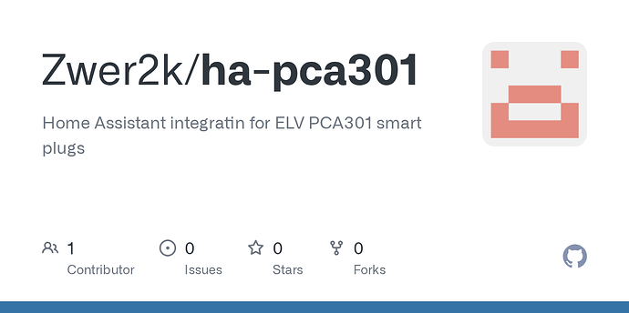

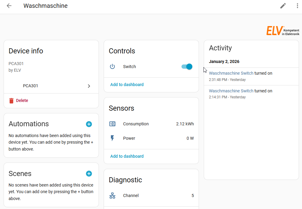

Since the HA integration did not work, but I still had a few of the PCA301 adapters in use via a workaround Fhem → IO-Broker → HA, I decided to write a new integration for it.
The integration works really well for me, adapters can be switched and the measured values are also delivered.
Here is the link to the Github repository:
Integration via HACS, see also the instructions in the repo.
It should also be available via the HACS library shortly.
