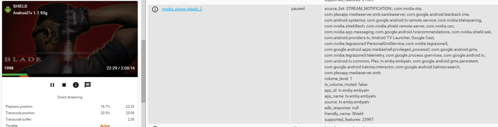

I have an automation that dims lights in my living room when content is playing on my living room nvidia shield, and brightens lights when the state is paused, idle, or standby. This works great in plex. But the device state when using emby is reported as “paused”, even when the app is just opened and continues to stay that way even content is playing in the app. I have a thread on the emby forums, but don’t know much about how the device state is set, why it works in plex, and why it doesn’t in emby. Any tips or links to device state documentation would be appreciated.

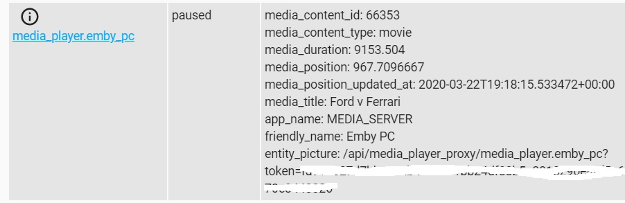

That is strange, my emby media player shows all the states, what the content type is, user, and the playing content. I use it to automate lights. This is the emby theater on my pc:
Sure you have the right entity ?

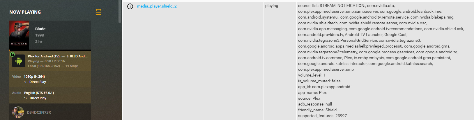

Yes it’s my living room Nvidia Shield. Play states work for every other app I’ve tried. Plex, Netflix, Prime, etc.
Here’s an example of plex playing
Oh I see, I use the direct link to emby:
