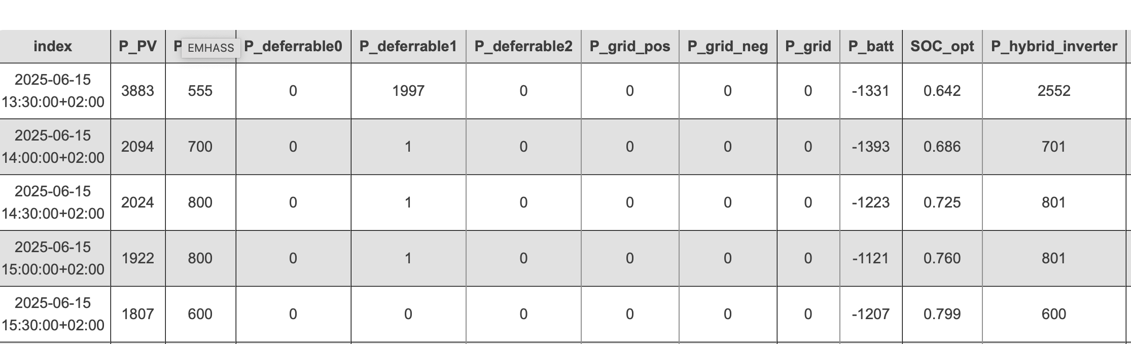

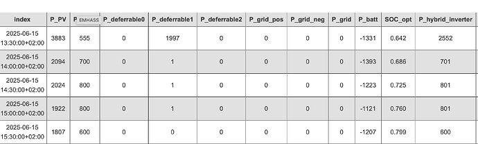

Hi there, I am pretty new to Home Assistant and EMHASS as well. I have been using a commercial EMS for some years (energybase here in Germany) which is no longer supported.
I decided to give EMHASS a try and it looks very promising.
For now I am just trying to push the battery load to PV peak hours.
I’ve set up a defferabl load with 0 hours and configured battery as well as a inverter close to mine.
So inverter AC limit is 10KW, battery charge/discharg is around 10KW, battery capacity is 7.7KWh. Battery should be a 5% SOC at end of the forecast window (using day-ahead).
I configured the battery load as 7700 Wh in EMHASS.
Running the optimization gives me this:
Looks like the battery capacity is wrong.
Setting it to 77000Wh in EMHASS it looks more reasonable.
Am I doing something wrong?

I would check if all P parameters are in W and Wh and take it from there.
Thanks, this is my config:

Should be fine I guess.
Checking the optimization forecast re battery discharge, I am getting this:

I want to use ‘operating_timesteps_of_each_deferrable_load’ to pass at runtime. I run 30 min optimization, 1h deferrable = 2 timesteps.
The Optimization runs ‘Optimal’ . Looking at the EMHASS graph I get this:
Is this a bug?
[2025-06-15 13:45:02 +0200] [21] [INFO]  >> Obtaining params:
[2025-06-15 13:45:02 +0200] [21] [INFO] Passed runtime parameters: {'entity_save': 'True', 'publish_prefix': 'mpc_', 'prediction_horizon': 48, 'pv_power_forecast': [3883, 2094, 2024, 1922, 1807, 1664, 1490, 1315, 1179, 1072, 943, 794, 629, 430, 234, 90, 22, 0, 0, 0, 0, 0, 0, 0, 0, 0, 0, 0, 0, 0, 0, 0, 16, 77, 207, 403, 656, 983, 1432, 1992, 2636, 3253, 3679, 3931, 4011, 3979, 3870, 3435, 2751, 2334, 2246, 2251, 2253, 2197, 2032, 1782, 1468, 1175, 912, 708, 556, 389, 215, 84, 21, 0, 0, 0, 0], 'num_def_loads': 3, 'nominal_power_of_deferrable_loads': [0, 2000, 0], 'operating_timesteps_of_each_deferrable_load': [0, 1, 0], 'treat_deferrable_load_as_semi_cont': [False, False, False], 'set_deferrable_load_single_constant': [True, True, True], 'start_timesteps_of_each_deferrable_load': [-8, -8, 6], 'end_timesteps_of_each_deferrable_load': [12, 14, 14], 'def_current_state': [False, True, False], 'soc_init': 0.6, 'soc_final': 0.23, 'load_cost_forecast': [0.1451, 0.1458, 0.1458, 0.1489, 0.1489, 0.1511, 0.1511, 0.1914, 0.1914, 0.2374, 0.2374, 0.2546, 0.2546, 0.281, 0.281, 0.2965, 0.2965, 0.2931, 0.2931, 0.2676, 0.2676, 0.2959, 0.2959, 0.2677, 0.2677, 0.2519, 0.2519, 0.2421, 0.2421, 0.2363, 0.2363, 0.2537, 0.2537, 0.2702, 0.2702, 0.282, 0.282, 0.292, 0.292, 0.2691, 0.2691, 0.2096, 0.2096, 0.1666, 0.1666, 0.1548, 0.1548, 0.1535], 'prod_price_forecast': [-0.0147, -0.014, -0.014, -0.0111, -0.0111, -0.0091, -0.0091, 0.029, 0.029, 0.0724, 0.0724, 0.0886, 0.0886, 0.1135, 0.1135, 0.1282, 0.1282, 0.125, 0.125, 0.1008, 0.1008, 0.1276, 0.1276, 0.1009, 0.1009, 0.0861, 0.0861, 0.0769, 0.0769, 0.0714, 0.0714, 0.0878, 0.0878, 0.1034, 0.1034, 0.1144, 0.1144, 0.1239, 0.1239, 0.1023, 0.1023, 0.0462, 0.0462, 0.0056, 0.0056, -0.0055, -0.0055, -0.0067], 'alpha': 0.5, 'beta': 0.466, 'load_power_forecast': [555, 700, 800, 800, 600, 200, 600, 500, 500, 3200, 1300, 1000, 700, 800, 700, 900, 500, 400, 300, 400, 400, 300, 600, 500, 500, 400, 500, 0, 600, 700, 300, 600, 500, 500, 600, 500, 600, 200, 400, 400, 200, 400, 300, 400, 200, 800, 1000, 700], 'weight_battery_charge': 0.041, 'weight_battery_discharge': 0.009}
[2025-06-15 13:45:02 +0200] [21] [INFO]  >> Setting input data dict
[2025-06-15 13:45:02 +0200] [21] [INFO] Setting up needed data
[2025-06-15 13:45:02 +0200] [21] [DEBUG] Initialized Optimization with retrieve_hass_conf: {'optimization_time_step': Timedelta('0 days 00:30:00'), 'historic_days_to_retrieve': 10, 'sensor_power_photovoltaics': 'sensor.inverter_ingangsvermogen', 'sensor_power_photovoltaics_forecast': 'sensor.p_pv_forecast', 'sensor_power_load_no_var_loads': 'sensor.power_load_no_var_loads', 'load_negative': False, 'set_zero_min': True, 'sensor_replace_zero': ['sensor.inverter_ingangsvermogen'], 'sensor_linear_interp': ['sensor.inverter_ingangsvermogen', 'sensor.power_load_no_var_loads'], 'method_ts_round': 'first', 'continual_publish': False, 'hass_url': 'http://supervisor/core/api', 'long_lived_token': '4a653cd73437817aa25835895766b233a4f4fb77ce6eaa1ea5ad42337de7bfd955616ee0c9c95b4e2829ff13d5b6cefe51f1801618726893', 'time_zone': <DstTzInfo 'Europe/Brussels' LMT+0:18:00 STD>, 'Latitude': 50.789456233171535, 'Longitude': 5.592577457427979, 'Altitude': 110}
[2025-06-15 13:45:02 +0200] [21] [DEBUG] Optimization configuration: {'costfun': 'self-consumption', 'logging_level': 'INFO', 'set_use_pv': True, 'set_use_adjusted_pv': False, 'adjusted_pv_regression_model': 'LassoRegression', 'adjusted_pv_solar_elevation_threshold': 10, 'set_use_battery': True, 'number_of_deferrable_loads': 3, 'nominal_power_of_deferrable_loads': [0, 2000, 0], 'minimum_power_of_deferrable_loads': [0, 0, 0, 0], 'operating_hours_of_each_deferrable_load': [2, 2, 2, 2], 'treat_deferrable_load_as_semi_cont': [False, False, False], 'set_deferrable_load_single_constant': [True, True, True], 'set_deferrable_startup_penalty': [3, 5, 5, 0], 'delta_forecast_daily': Timedelta('1 days 00:00:00'), 'load_forecast_method': 'list', 'load_cost_forecast_method': 'list', 'load_peak_hours_cost': 0.1907, 'load_offpeak_hours_cost': 0.1419, 'production_price_forecast_method': 'list', 'photovoltaic_production_sell_price': 0.065, 'set_total_pv_sell': False, 'lp_solver': 'COIN_CMD', 'lp_solver_path': '/usr/bin/cbc', 'lp_solver_timeout': 45, 'num_threads': 0, 'set_nocharge_from_grid': False, 'set_nodischarge_to_grid': False, 'set_battery_dynamic': True, 'battery_dynamic_max': 0.85, 'battery_dynamic_min': -0.5, 'weight_battery_discharge': 0.009, 'weight_battery_charge': 0.041, 'weather_forecast_method': 'list', 'open_meteo_cache_max_age': 30, 'start_timesteps_of_each_deferrable_load': [-8, -8, 6], 'end_timesteps_of_each_deferrable_load': [12, 14, 14], 'load_peak_hour_periods': {'period_hp_1': [{'start': '08:00'}, {'end': '17:00'}], 'period_hp_2': [{'start': '08:00'}, {'end': '17:00'}]}, 'operating_timesteps_of_each_deferrable_load': [0, 1, 0], 'def_current_state': [False, True, False]}
[2025-06-15 13:45:02 +0200] [21] [DEBUG] Plant configuration: {'maximum_power_from_grid': 4000, 'maximum_power_to_grid': 6000, 'pv_module_model': ['JA_Solar_JAM72S01_385_PR', 'JA_Solar_JAM72S01_385_PR', 'JA_Solar_JAM72S01_385_PR'], 'pv_inverter_model': ['Huawei_Technologies_Co___Ltd___SUN2000_9KTL_USL0__240V_', 'Huawei_Technologies_Co___Ltd___SUN2000_9KTL_USL0__240V_', 'Huawei_Technologies_Co___Ltd___SUN2000_9KTL_USL0__240V_'], 'surface_tilt': [35, 35, 15], 'surface_azimuth': [90, 270, 180], 'modules_per_string': [6, 6, 13], 'strings_per_inverter': [1, 1, 1], 'inverter_is_hybrid': True, 'compute_curtailment': True, 'battery_discharge_power_max': 5000, 'battery_charge_power_max': 5000, 'battery_discharge_efficiency': 1, 'battery_charge_efficiency': 0.95, 'battery_nominal_energy_capacity': 15000, 'battery_minimum_state_of_charge': 0.12, 'battery_maximum_state_of_charge': 1, 'battery_target_state_of_charge': 0.12}
[2025-06-15 13:45:02 +0200] [21] [DEBUG] Solver configuration: lp_solver=COIN_CMD, lp_solver_path=/usr/bin/cbc
[2025-06-15 13:45:02 +0200] [21] [DEBUG] Number of threads: 2
[2025-06-15 13:45:02 +0200] [21] [INFO] Retrieving weather forecast data using method = list
[2025-06-15 13:45:02 +0200] [21] [DEBUG] get_weather_forecast returning:
                           yhat
ts
2025-06-15 13:30:00+02:00  3883
2025-06-15 14:00:00+02:00  2094
2025-06-15 14:30:00+02:00  2024
2025-06-15 15:00:00+02:00  1922
2025-06-15 15:30:00+02:00  1807
2025-06-15 16:00:00+02:00  1664
2025-06-15 16:30:00+02:00  1490
2025-06-15 17:00:00+02:00  1315
2025-06-15 17:30:00+02:00  1179
2025-06-15 18:00:00+02:00  1072
2025-06-15 18:30:00+02:00   943
2025-06-15 19:00:00+02:00   794
2025-06-15 19:30:00+02:00   629

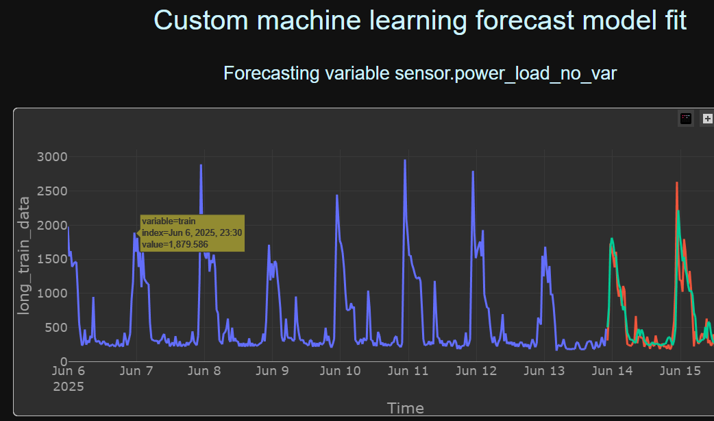

Would someone be able to assist me on this. I have no idea where to start looking but esentially the p_load forecast values are out of sync with current time.
The parameters being passed are as follows:
Blockquote
ml_forecast_model_fit:
url: http://localhost:5050/action/forecast-model-fit
method: POST
content_type: ‘application/json’
payload: >-
“days_to_retrieve”: 9,
“model_type”: “load_forecast”,
“var_model”: “sensor.power_load_no_var”,
“sklearn_model”: “KNeighborsRegressor”,
“num_lags”: 48,
“split_date_delta”: “48h”,
“perform_backtest”: “True”

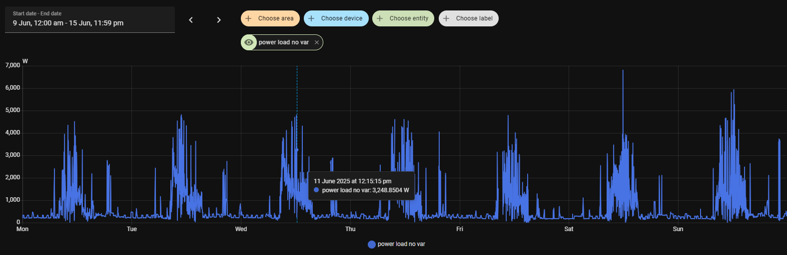

My power_load_no_var_loads looks something like this.

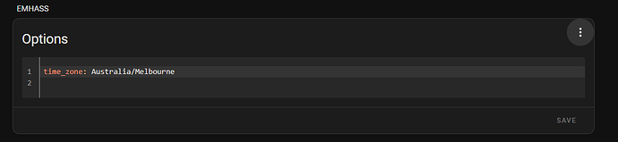

Seems like a timezone issue but I’ve set it in the EMHASS config
Running HA supervisor & its set to the same zone…
There is a TZ issue with the forecasts, please include some comments here:
Thanks, is there a workaround you’re implementing at the moment. Im thinking of just loading the sensor with previous days values?
