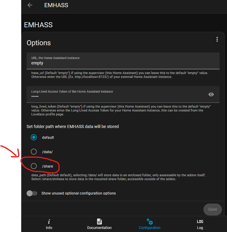

a) fail to locate the config.json-file, have been digging around in the file system (both with file editor and ssh/terminal) but still haven’t been able to locate it

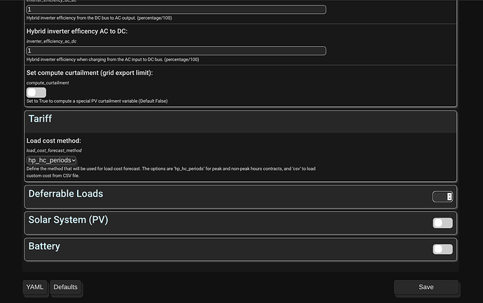

b) trying to use the GUI-config (reacable via the gear cog in the graphical interface); here I seem to miss information(?), e.g. for deferrable loads I can only fill in a numerical value and cannot put in more info (which would be needed in order to configure how I want these loads to be handled I assume). Further nothing seems to happen if I click the yaml, default or save buttons at the bottom.
Have tried to uninstall and reinstall Emhass several times but still I cannot seem to be able to configure anything.

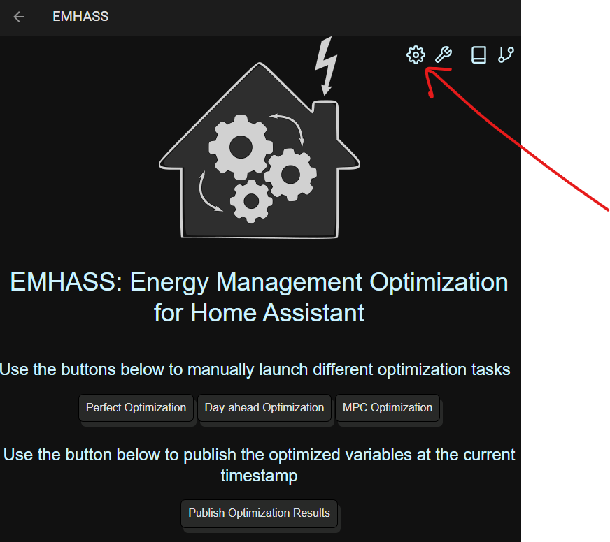

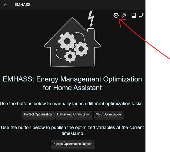

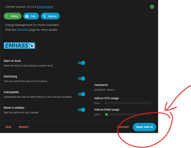

After install go to “Settings > Add-ons > EMHASS” and then click on “Open Web UI”:
Then click on the “gear” icon:
Then you will reach the configuration page and fill in all the needed parameters. No need to go search for any config.json or whatever file using a terminal.
A save button is at the bottom to save your configuration.
There is everything that you need on that page.

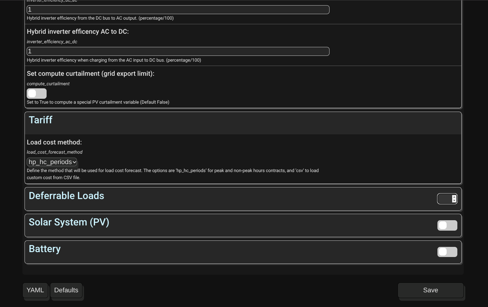

That will configure the energy optimizations. After that and after launching an optimization, data will be published to HA. You then need to handle that information yourself using dedicated automations to control your real loads/switches.
The “List and box view toggle” and the “YAML” button work fine for me.

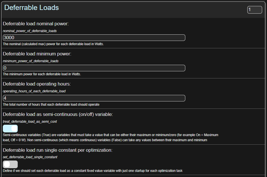

You mentioned that you can only enter a number into the deferrable loads config. That’s because EMHASS only needs to know a couple of things about deferrable loads. Firstly how many you have (pool pump, hot water, EV charging etc) and whether they are a static load (e.g. a pool pump) or a variable load (e.g. charging an EV) and how long you want to run these loads. You can also manage things like operating hours.
But again this configuration vis the gear may very well be overwritten of never used if you pass this info every time you POST to EMHASS.

I fully understand what you mean by the cog gear and I do get the idea that I should use the GUI to input any settings needed but this is where I think I miss something crucial.
Referring to the included picture I can write a value in ‘deferrable loads’ and I can click save, but if I go to some other page and come back nothing is saved.
I probably would expect that I could click on ‘deferrable loads’ and get more options available (like setting how many hours per day the load should be available and so on) but nothing happens.
If I click on ‘yaml’ or ‘defaults’ nothing happens either.
I am normally using a chromebook running chrome to access Home Assistant (running on a Home Assistant Green) for setting things up but have also tried running firefox, and trying to access the settings using my mobile (both app and browser) so something seems to elude me here…
Note; not saying there is anything wrong with Emhass, on the contrary from what I can see it would help me much. I would guess it is either something really obvious that I miss here or I have some incompatibility in my HA setup…
What I am trying to accomplish as a first use case is something rather simple; have an electrical water boiler that I can control using a shelly and would like to run it the cheapest hours (based on prices from NordPool).

Ok I understand.
That is some wierd behavior you are having there.
But yes definetly putting an integer number on that box should deploy a series of options that you can fill in to define each deferrable load.
This is what I have for 1 defeerable load:
I’m not able to reproduce your issue, so this could be tricky to solve.
Maybe it can be fixed with some cache clearing and a HA restart?
For my both this and the YAML button works well.
Tried to run the browser in incognito mode (which should be similar to clear the cache (unless you mean clean a cache in Home Assistant somehow?)), and also rebooted the Home Assistant Green in Safe Mode and even while I still could access the GUI the behavior was the same :frowning:
Is there any logs from HA that could possibly give some clues?
And while I understand that making any settings should be done through the GUI is there any way to access a settings file since the GUI settings does not work for me?
I am running Home Assistant on a Home Assistant Green system it is the HAOS version - shouldn’t make any difference I believe?
This is odd since I haven’t really tinkered with HA much I haven’t set up so many things that could interfere with EMHASS I guess…
Well, if anyone has any idea what to try I am all ears :slight_smile:

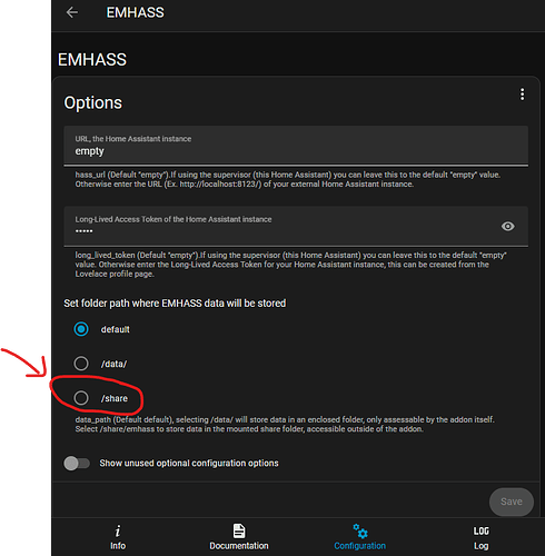

Yes, go to the add-on configuration pane and select the folder path as the “/share” folder:
Then you should access the share partition using the terminal add-on and “cd share”:
In there you can try and edit the “config.json” using “nano config.json” and then save and restart the EMHASS add-on.
