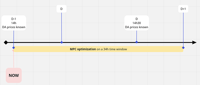

Question: is EMHASS capable of working with forecasts that go beyond 24h from now?
Context:
In Belgium, the day-ahead market prices are published around 14h on day D-1. From that point on, I have all price information until end of the next day (day D), so I could envision to optimize a time window of max 34h:
I tried to run a naive MPC optimization, providing all required input timeseries as runtime parameters:
Note: I use 30min timesteps, which explains why prediction horizon is that long.
This is taken at 20h50 on day D-1, so there are 55 remaining half hours until end of day D. For each of these half hours, I provided price and power inputs.
Running the naive MPC optimization results in following output:

It seems that the dataframe “df_input_data_dayahead” only has a size of 48, even though the provided input timeseries for load and PV power forecast were sufficiently long for the prediction_horizon of 55.
Why doesn’t the optimizer accept prediction horizons longer than 24 hours?

I believe you can run the day-ahead optimisation with more than 24 hours (48 entries), but the MPC is limited to 48 entries.
So in your case, I would suggest when you receive the full 34 hour forecast run the day-ahead optimisation with your full data and then run your MPC optimisation with a shorter time frame.

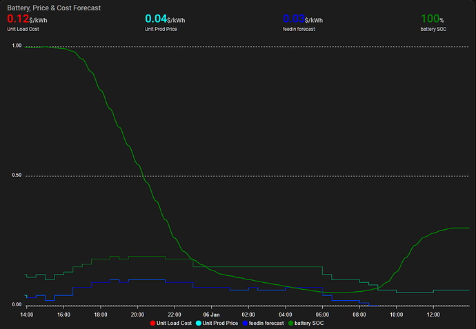

I am testing EMHASS as an add-on to HA and I am seeing some weird behaviour of my battery. It looks like it’s charging although I am having almost no production from my PV here in dark Europe these days. If there is some production this is instantly consumed by the current home loads I have active.
Below are extracts from my config file showing the battery parameters and some graphs of the result of todays dah ahead optimisation.

So bottom line I don’t understand why my battery charges to 50%, which explains the discharge around 18h.
Yves
You forecast a decent amount of pv generation. Your system assumes to store this for usage later in the day deu to price differential. Tweak your efficiency (eg to 90% instead of 95%) this way the algorithm will not optimize at a mere 2 c difference.
Alternatively you can play with the weight, bot are now at 1, would put discharge to 0 and charge to for example 0.05 or 0.1, assuming a cost of 5c or 10c to charge the battery.
That should result in the PV being used directly to load instead of storing it.
