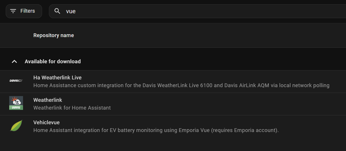

What integration are you referring to? The only thing I see about Vue requires having a vehicle connected to the account:
Update: you have to add a custom repository as an integration - GitHub - magico13/ha-emporia-vue: Home Assistant Integration for Emporia Vue Energy Monitor
