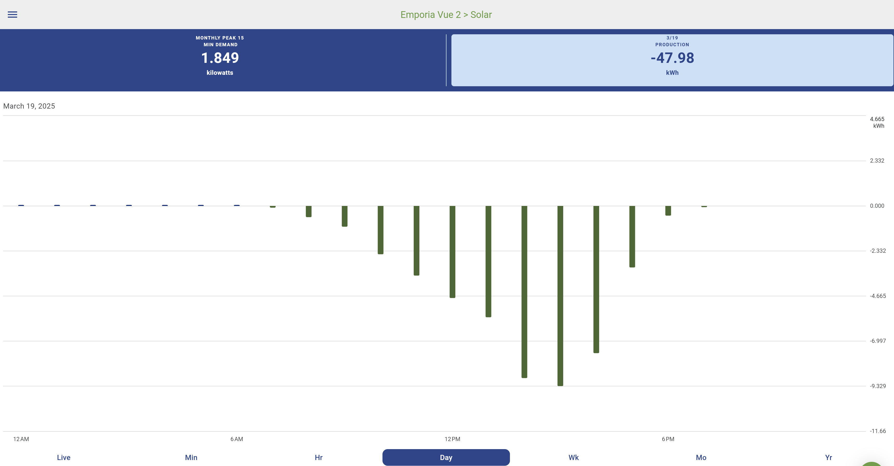

We just had solar installed earlier this month and I’m trying to wrap my head around an issue I’m having getting the solar production displayed properly.
I’m using an Emporia Vue 2 energy monitor to track energy use and solar production. It’s working well and I have 2 CTs installed on the 2 solar hots coming into our panel and those circuits are merged into 1 for a proper combined total readout.
In HA it shows those sensors as a negative value so I created a helper template to flip those into positive values otherwise it complains:
{{ states('sensor.solar_energy_today')|float*(-1) }}
The new output is working correctly and HA doesn’t complain.
So here’s the issue: as you can see in the screenshots it’s reporting the daily production with a reset negative value each day which throws off the calculation (March 19th shown) Emporia reports 47.98 kWh but HA deducts 10.82kWh each day. It’s driving me mad
