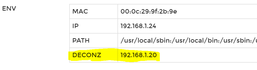

  3. In Portainer (can probably be added to the command above though), add the ENV variable to the DiyHue container “DECONZ” with the IP of your HomeAssistant server as the value:

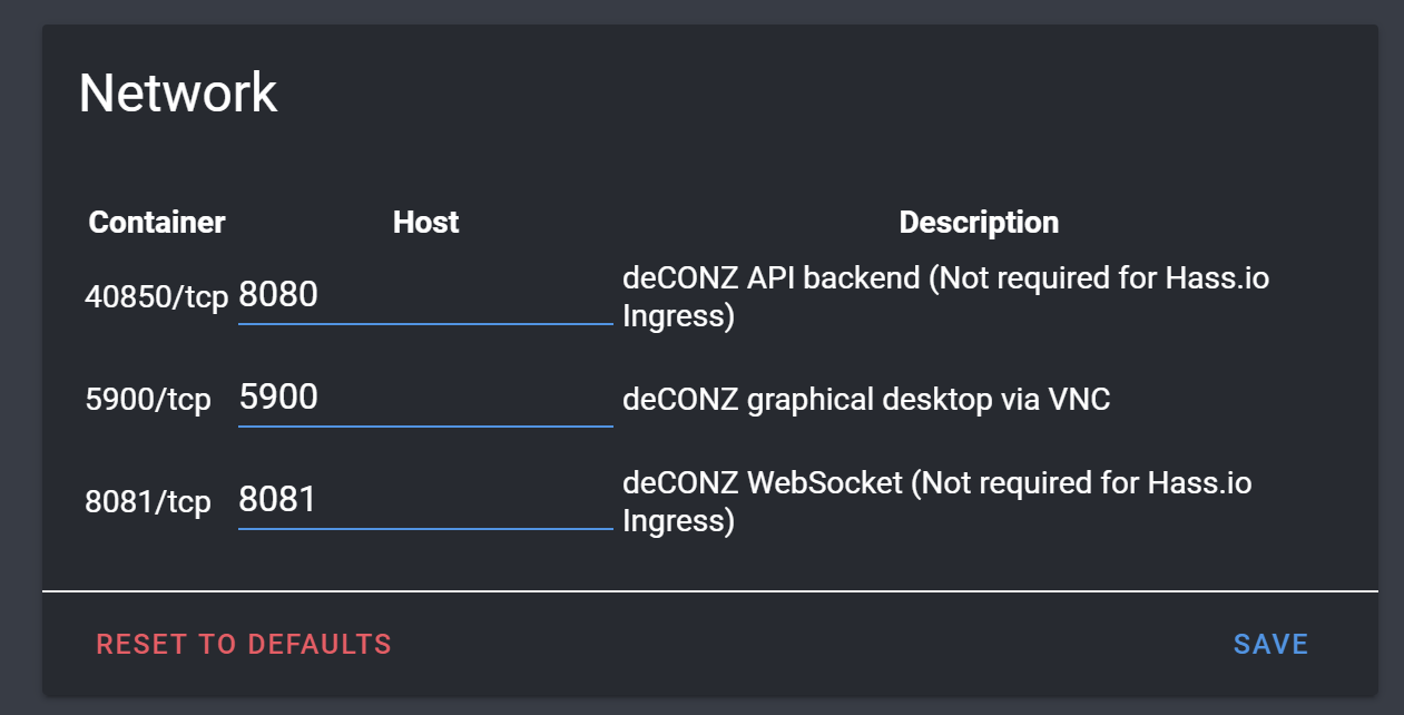

  4. In the Network section of the Deconz add-on in Hass.io/Supervisor set the ports as follows:
