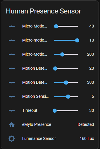

Works on WiFi (2.4 Ghz) and after a little foobling with it in the LocalTuya integration, have it doing presence detection and illuminance metering… comes with nice long USB cable, but no adapter.
Working on seeing if I can get the sensitivity controls working.
On Edit: I did get the controls working, here are their entity ID’s:
Presence is a binary with the values of “presence” and “none”.
Luminance is a sensor that returns a value (I called it Lux, but not sure what actual unit is, if any)
The 2 sensitivity entities are numbers in the 0-10 range with step=1
The 4 limit entries are numbers on the 0-600 range with step=10. In the phone app, the lower and upper limits can be the same, but not overlap… I couldn’t figure out any way to do that in HA, so not sure what happens if you make the lower limt greater than the upper, for instance…

For that list of entity ID’s I was presented when adding the device, I just selected each one, named it and defined the value types/ranges (i.e. Sensitivity levels 1-10 in steps of 1, Range in 0-600CM in steps of 10, etc…). Once done they controls show up in HA with the appropriate controls (sliders, etc…) to manage them.

Finally, here’s what you get for the controls as a default once you add it:
Let me know if if anyhing else…
