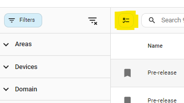

Then click on the entity selection button
