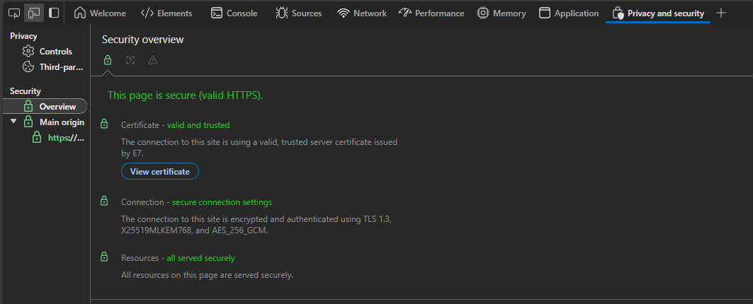

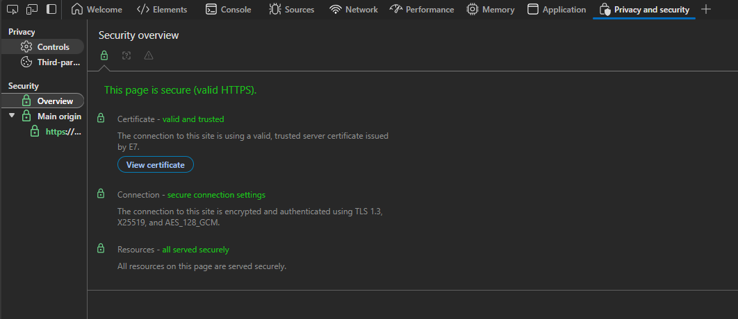

When looked at in Developer Tools (ctrl + shift + i):
Default HA nginx:
PQC HA nginx:
If done correctly, the “Connection” box will now show X25519MLKEM768 instead of X25519 and AES_256_GCM instead of AES_128_GCM.
