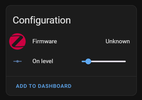

After a little more investigation. I’ve concluded that the Enbrighten Zigbee Dimmer 43080 wall dimmer doesn’t support the transition time attributes. For instance in the HA configuration page for the dimmer it only shows these attributes in the Configuration section:

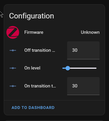

I also have a dimmer module, Leviton Decora Smart Plug-in Dimmer, Zigbee Certified, DG3HL-1BW, White, and it shows this in the Configuration section.
So my search is for a Zigbee smart wall dimmer that does support the transistion times. Any recommendation would be appreciated. I’m converting over from Insteon devices which generaly support this and I assumed Zigbee would.
