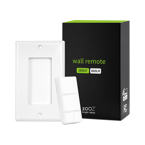

Hello, I am looking for a multi-channel (min. 4-channel) RF remote control so that I can also control my gates using physical buttons. It is important to me that the connection is encrypted.
If you already have Z-Wave setup with your home assistant instance, I would recommend the Zooz Wall Remote:
It supports S2 encrypted communication between supported Z-Wave Controllers.
It is advertised as being mounted to the wall, but you can just not mount it and it works just the same.
