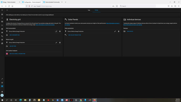

I am not sure what’s wrong but trying to get my house’s energy data into the new Energy panel.
Firstly when I clicked on the Lightning bolt to set it up the only entity that was available was the “Envoy Lifetime Energy Production” for both the generation and consumption.
I know that it’s wrong but this is what it looks like
This is what is currently displayed and of course it’s nonsense because the two entities are the same.

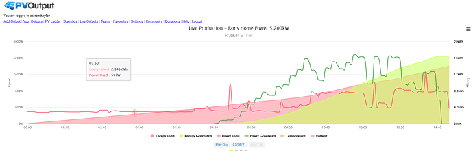

I know all the monitoring works as it now goes to PVOutput.org
And this is the data in my HA using a HA Lovelace History Card

The same data (Generation and Consumption) is presented to PVOutput.org and this is the result
PVOutput.org calculates my import and exported data and provides a net for the day.
Why does HA need a separate input to know how much is returned to the grid (exported)?
This is what PVO does with data and the red line is below the green line from about 08:00hrs to 17:00hrs so all consumption energy is coming from solar
This is all with exactly the same data.
