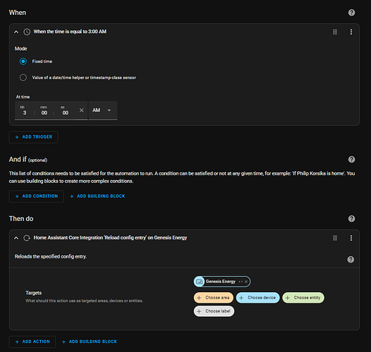

What’s the recommended way to get this integration to automatically pull from genesis?
I noticed I have to restart HA (or reload the integration in the UI) to get it to trigger. I’m still finding my way around HA so might be missing something, so not sure if this is right, but have in the meantime setup an automation to reload the config entry at 3am daily which does appear to work:

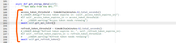

Turns out the config reload doesn’t work - testing a few more options and will report back after a few days of testing.
Calling “update entity” on them after removing the time-based token validity check in the api.py file seems to have done the trick - it’s been working reliably in ways I haven’t had to touch for a while now.
