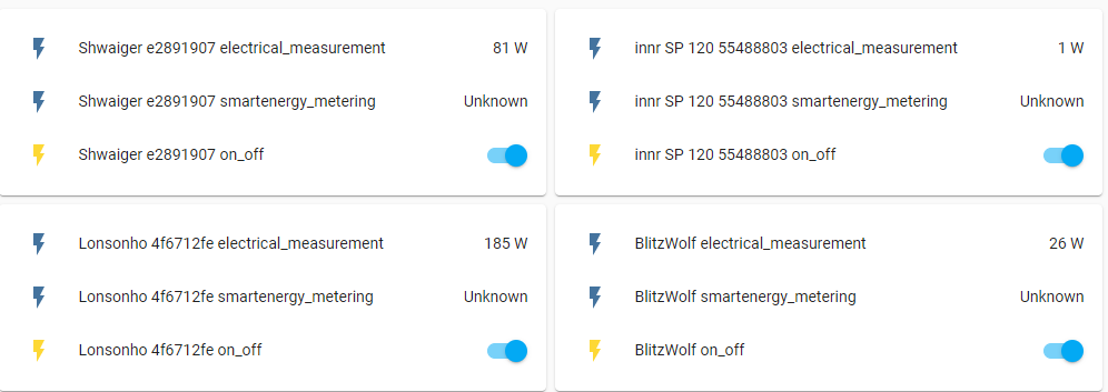

## The problem
In ZHA smart plugs are not showing value for used energy counter. I have tested 4 different types of plugs and all of them show:
smartenergy_metering - 'unknown'
When I use Manage Clusters I can see that all those plugs report used energy value in cluster 0x702, attrid 0 as current_summ_delivered
So it seems that instead of smartenergy_metering ( I don't know from which cluster it comes in existing integration)
should be used cluster: **Metering (Endpoint id: 1, Id: 0x0702, Type: in)**, attribute: **current_summ_delivered (id: 0x0000)**
I have checked with:
BlitzWolf BW-SHP13, Innr SP 120, Schwaiger ZHS15, Lonsonho 16A Energy Monitoring Plug and all of them report used energy counter in cluster:0x702, attrid:0
Same problem reported also by other users:
(https://github.com/home-assistant/core/issues/34090#issuecomment-745948613)

All those applies to most Zigbee power plugs or other Zigbee devices with integrated energy meters:
Tuya TS0121 → [Device Support Request] BlitzWolf BW-SHP13 smart plug (aka Tuya TS0121) · Issue #605 · zigpy/zha-device-handlers · GitHub
BlitzWolf BW-SHP13 (OEM version of Tuya TS0121) → [Device Support Request] BlitzWolf BW-SHP13 smart plug (aka Tuya TS0121) · Issue #605 · zigpy/zha-device-handlers · GitHub
Develco Norwegian HAN Adapter (Develco EMIZB-132) → Add support for Develco Products A/S EMIZB-132 Norwegian HAN adapter · Issue #267 · zigpy/zha-device-handlers · GitHub
Develco Prosumer Meter (Develco SMMZB-310101)
Develco Smart Plug Mini (Develco Frient SPLZB-131) → [Device Support Request] Develco Frient SPLZB-131 Smart Plug Mini · Issue #857 · zigpy/zha-device-handlers · GitHub
Immax Plug-230V-ZB3.0 Smart Plug
Innr SP 120 (a.k.a. Innr SP120) → No power consumption readings from Innr smart plug SP120? · Issue #34090 · home-assistant/core · GitHub
Lonsonho 16A Energy Monitoring Plug (OEM version of Tuya TS0121) → [Device Support Request] BlitzWolf BW-SHP13 smart plug (aka Tuya TS0121) · Issue #605 · zigpy/zha-device-handlers · GitHub
SmartThings Smart Plug (UK)
Schwaiger ZHS15 → ZHA plugs - smartenergy_metering > wrong cluster · Issue #44539 · home-assistant/core · GitHub
Rehentele 16A Energy Monitoring Plug (OEM version of Tuya TS0121) → [Device Support Request] BlitzWolf BW-SHP13 smart plug (aka Tuya TS0121) · Issue #605 · zigpy/zha-device-handlers · GitHub
Aqara LUMI lumi.plug → ZHA plugs - smartenergy_metering > wrong cluster #44539
