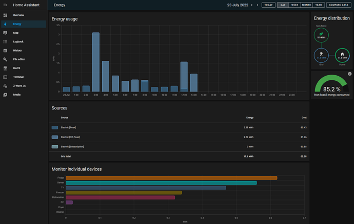

As it seems that like to fit a square in a circle, I’m trying to add my monthly subscription for electricity to the energy dashboard. I’m almost there but there is one last thing that I cannot do. I will try to list everything that I have tried to see if someone has a better idea on how I should run those things…

Then I created a Utility Meter called “Energy Electric Subscription” that uses this sensor. I now managed to show the 0 kWh and I can use an entity to track costs.

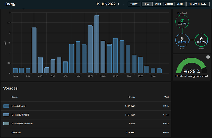

My Problem
How can I increase this total costs entity by a fixed amount (0.62) every day at 00:01. By doing this, I would have the right amount reflected in the Energy dashboard with the various aggregates (weekly, monthly, etc.).

For those interested, I found a working solution: adding a sensor that calculates the increase based on the day of the year.

I have an issue where the sensors work perfectly, but it shows the total for all days on my dashboard rather than the individual days total. How do I fix this?
