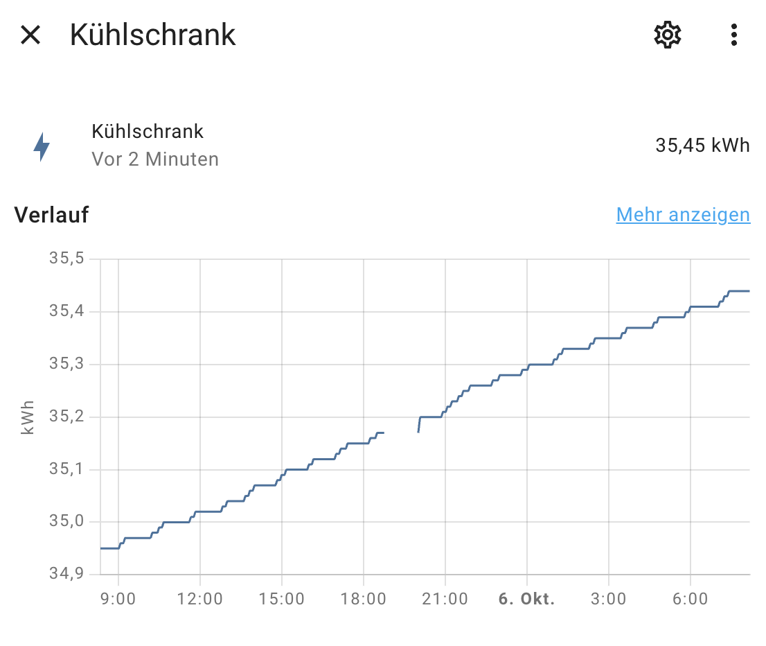

I have been having problems with my energy dashboard since moving from ZHA to Z2M. I have some values that do not fit.

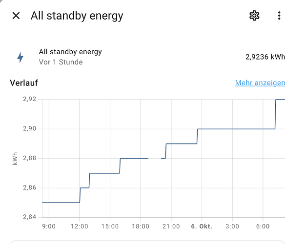

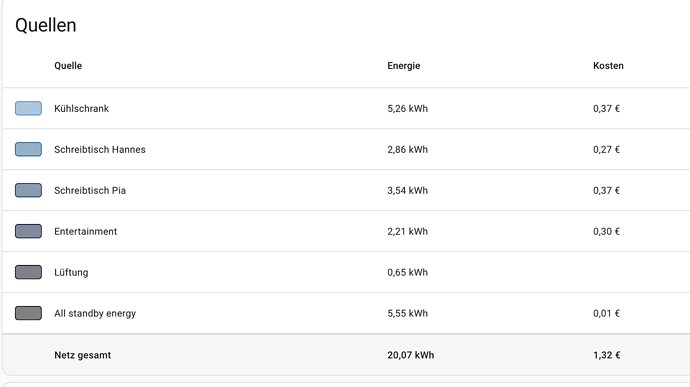

“All Stanby Energy” for example supposedly consumes 5.55kW, although the entity itself only shows 2.9kW.
The calculation of the electricity costs is also completely incorrect. (Have not changed anything here)

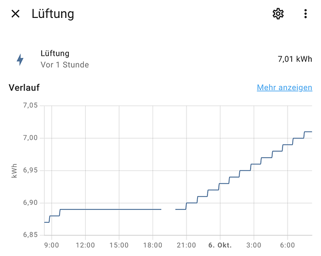

Consumption of “ventilation” also clearly too little.
So presumably all devices are somehow affected…

The All-standby, might be a “template sensor”, which ofcause gather it’s data(what it can, cording to the “template” from the data your devices report to HA) how the discrepancy, mentioned,occur only your self can figure out, as noone can ever know what you mean by “Supposedly”, or how/what this ASE-sensor/device is.
