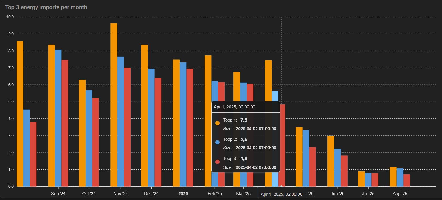

I started to automate against the powerpeaks in may this year and it is quite frustrating, i am on my way but the reporting for it is painful!
I am running HA on a rather powerful NUC, so i have the privilege to make powerful calculations from the database…
So what i have done is to crank up the recorder to told 400 days (one year + one month), then i have created a rather complex SQL query, asking the powermeter sensor for the three tops each month. it works, BUT, it is extremely CPU intensive, and the sensor dont store the values exactly by the hour (HH:00:00).
That introduces a small error (normally only differs a watt or two but extremely annoying!).
The SQL query are managed with a pyscript that i trigger with an automation.
(the pyscript transforms the query output into a sensor (need to store the data as attributes cause it is to much to store directly in the sensor…)
so as you imagine its a rather complex setup (i can share it if someone asks, but i think it is better to hide that mess) that i want to find an easier and find a more back to basic approach to!
The ApexCard on the other hand looks the way I want it, its just the way to get there that is so hard…
Considering the number of individual attempts, more or less failed it seems, I think that we have to wait for a native solution in the energy dashboard.
In the end all of Europe will have this way of measurement, after all there are as many users in Germany as in US (HA Analytics) so we will be quite a number of users that do have an interest in 3-peaks-power and the traditional energy view as a complement.

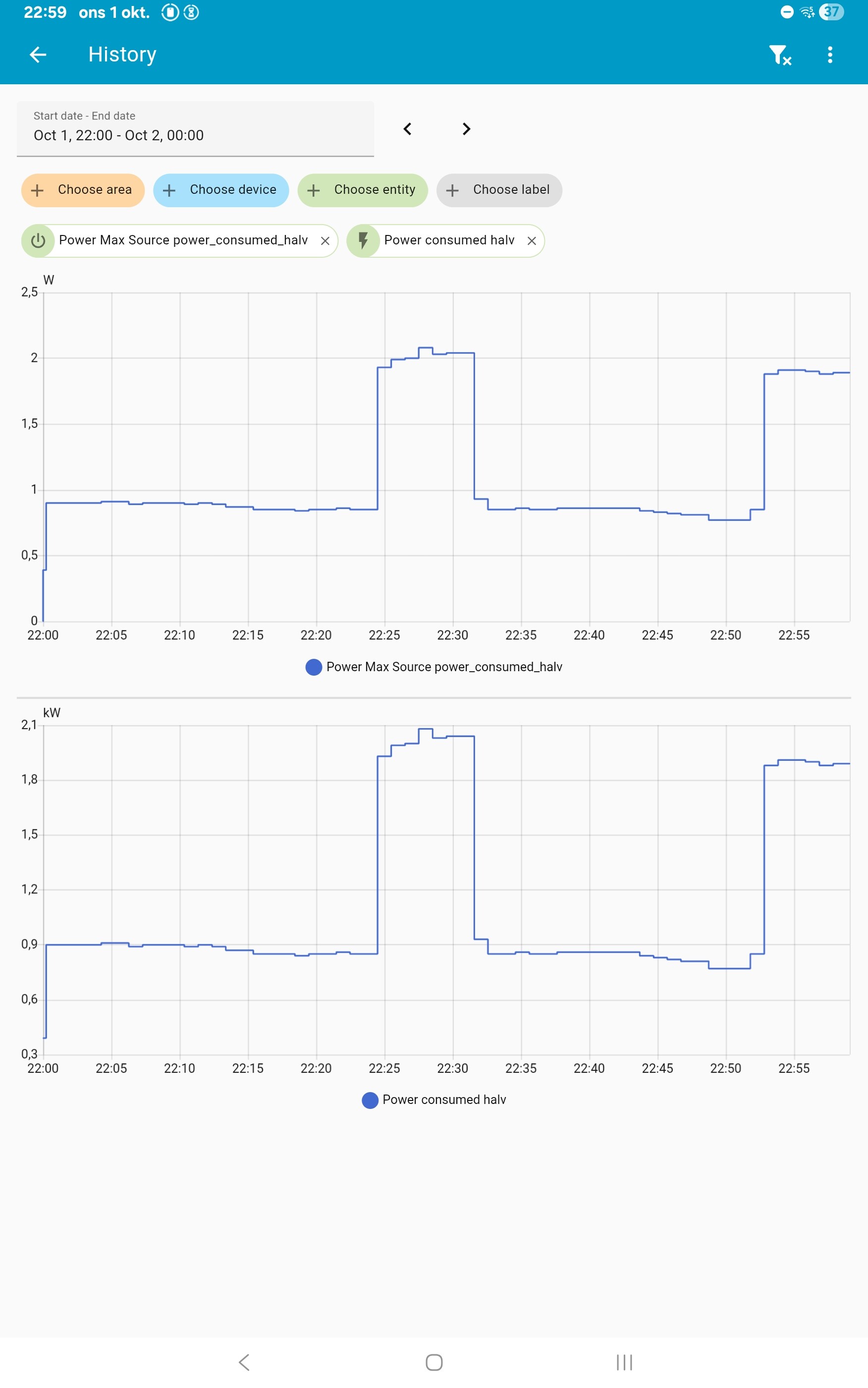

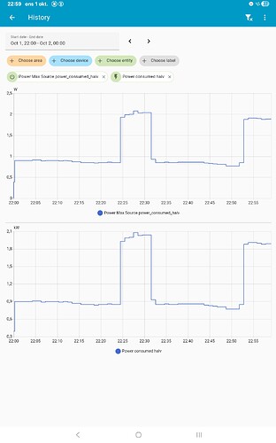

There seemscto be aproblem with the mimicking source sensor, as it does not correctly set the unit. The source entity is in kW while the Power Max entity is set up as W.
Changing the unit from W to kW recalculates the values so that does not serve well either.
Can the unit for sensors be more streamlined?
According to the documentation there is a mixture of W vs kW
