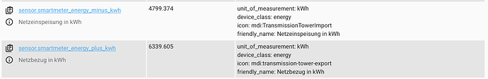

I see it now in the developer tools as the following:
which shows the correct values and I think also the properties are good??
When I now want to add it to the energy dashboard I see just the sensor from the ESP which is in Wh and I have no chance to add the sensor from the template.
Any hints what else to try? thanks a lot in advance
Your template sensors have no state_class.
A state_class of total or total_increasing is required for the sensors to be available in the energy dashboard.
The legacy template sensor platform does not support state_class as an option. You will have to use customize to add it to the sensors.
Or start using the new template integration which does support state_class.
You should also be supplying defaults for your float filters and be using an availability template to protect your energy dashboard from junk data.

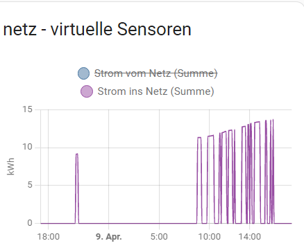

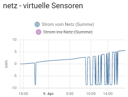

my problem is:
I want to take a kwh Sensor into two different virutal sensors. depend on a boolean sensor.
my template.yaml:
     - name: "Strom vom Netz"
       unique_id: strom_vom_netz
       icon: mdi:pulse
       unit_of_measurement: 'kWh'
       device_class: energy
       state_class: total_increasing
       state: >
         {% if is_state('switch.stromzkeller_laufrichtung2', 'off') %}
         {{ states('sen![Screenshot (45)|442x343](upload://nfia56Xn00HXq6J3T0mxOyslWDs.png)
![Screenshot (46)|435x330](upload://hKQAIeDSxFTUSGKcLhQ6U773eQF.png)
![Screenshot (47)|438x361](upload://vBN8eCp4AQTqCmMknkWvdWMf8ej.png)
sor.stromzkeller_zv_stromzahler_gesamt') | float }}
         {% else %}
         0
         {% endif %}
     - name: "Strom ins Netz"
       unique_id: strom_ins_netz
       icon: mdi:pulse
       state: >
         {% if is_state('switch.stromzkeller_laufrichtung2', 'on') %}
         {{ states('sensor.stromzkeller_zv_stromzahler_gesamt') | float }}
         {% else %}
         0
         {% endif %}
these virtual sensors go to energy dashboard. But the sensors do not work correct with the home assistant energy module
in energy Dashboard the values are wrong. can you help me ?
.Screenshot (45)Screenshot (46)
Screenshot (47)
