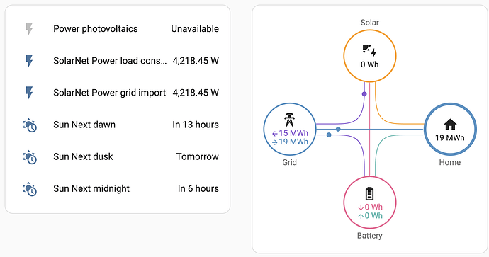

Energy dashboard showing different info than my sensors
Not sure if anyone has gone through the same. I have my Fronius inverter configured in HASSIO (latest version) and I see completely different information when looking at the sensor information or in Energy Dashboard.
Does anyone know what’s the issue and how to fix it?
Your info on the left is the current POWER consumption (4.2kW) - at this moment in time - which all seems to come from the grid.
The dashboard on the right shows the ENERGIE you have consumed over a certain period of time - but consuming 19MWh would have taken a significant amount of time. Unless you ran a secret kind of greenhouse that requires a lot of artificial light :stuck_out_tongue_winking_eye:

Any chance you know how to change the timing on the right? I agree, it seems to be total. Not greenhouse, otherwise I would have someone else fighting with this :grin:
