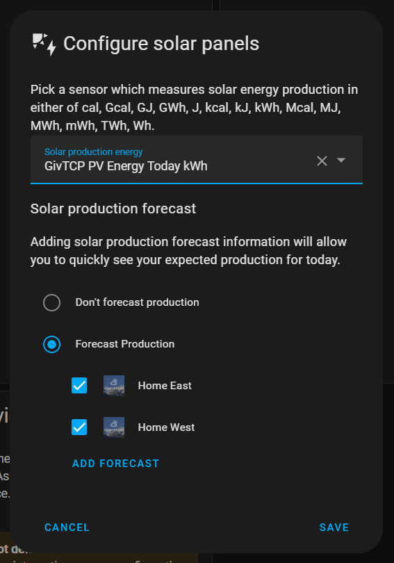

I have 2 arrays set up in Open Meteo:
and this is the config in the Energy dashboard, it sums them for you:
Have a look at the forum post for the Open Meteo Solar Integration, it also has template sensors to combine arrays
hi, thanks support, but how do you get this ‘GivTCP PV Enery Today kWh’ sensor in your energy dashboard? Did you make a template senor? If so, can you give me details pls? Tx!
That’s the sensor from my givenergy solar inverter
