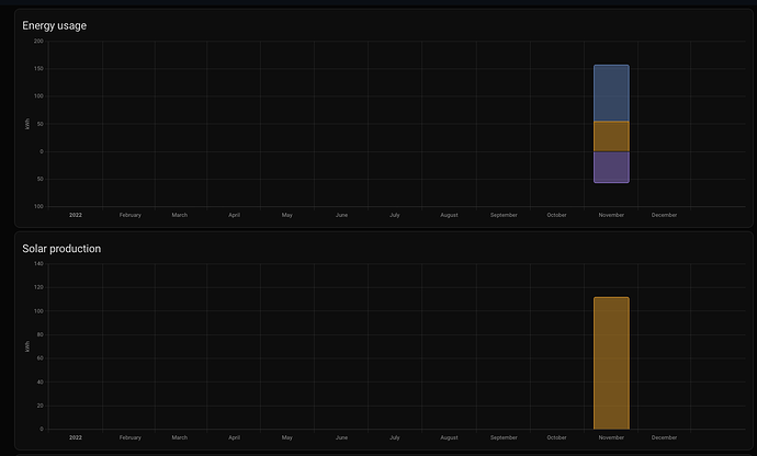

Tom,
here is a snip showing the units it’s looking for. The dashboard has units kWh only. It really looks like the battery sim thing has stuffed around with the data. Where do I go about changing these back?
i just checked in developer tools - states - and looked at the relevant sensors. The unit_of _measurement is set to the expected kWh.
i did find another set of similar sensors and their values are the stated error ones being Var. How do i change them?

I tried rebuilding the sma energy-meter. When i checked the debug logs in that a number of the ‘unit_of _measurement’ values varied from accepted W, kWh, and had values Var and VA.
This may be the issue? the batterysim integration may have changed them in the database? If so how do i change them back. All should be in form kWh???
